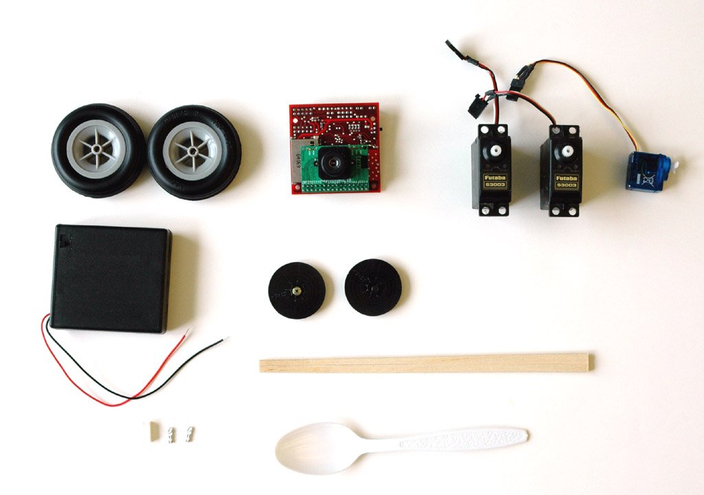

spoonBot requires the following parts:
  • 2 Continuous Rotation (hacked) servos
  • 1 normal micro-servo
  • 1 AA battery pack
    • One option includes a header for easy power connection
    • Another option includes a power switch (but no header)
  • 1 plastic spoon
  • 1 pair of chopsticks (or similar)
  • 2 Wheels
  • 2 servo horns (if wheels need adaptation)
  • 2 crimp terminals for battery pack (optional)
  • 1 header for battery pack (optional)
We used the following tools:
  • Hot Glue Gun
  • Philips Screw Driver
  • Cutters (for cutting chopsticks)
  • Soldering Iron (if battery pack needs header)

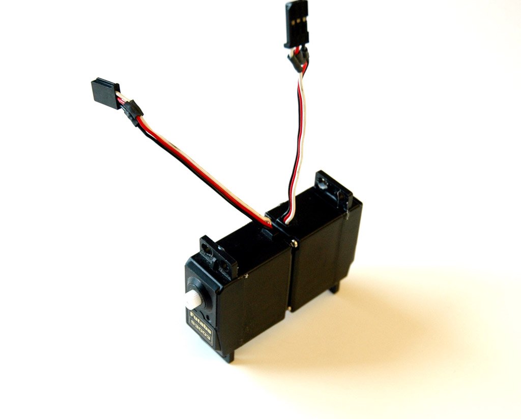

Step 1: Glue the Two Full Sized Servos Together
Step 1
In the picture, the servo wires have been shortened. You can do this if you like, but it is just as easy to tie them up when you are done.

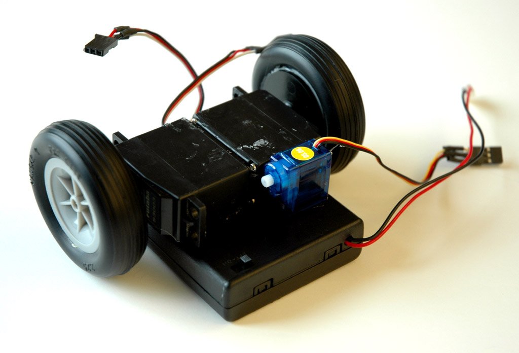

Step 5: Glue Micro-Servo to Base

Step 7: Calibrate Micro-Servo Position and Attach Spoon
Before connecting the servo horn with the spoon to the micro-servo, it is important to calibrate the servo position. This can be done by loading the CMUcam2 emulation firmware and then using the CMUcam3 Frame Grabber program. You can also use the SV servo command from a terminal program. Set the servo to the most extreme direction that would correspond to the spoon being placed in the lowest position. For our servo, this was servo value 255. In this position, it should not be possible for the spoon to push back against the base of the spoonBot.
Note, you may need to connect the external servo power jumper if it is not already installed.
See hardware-power for more details on servo power jumper.
See hardware-servo for information on connecting servos. The black wire should connect to the ground pin.

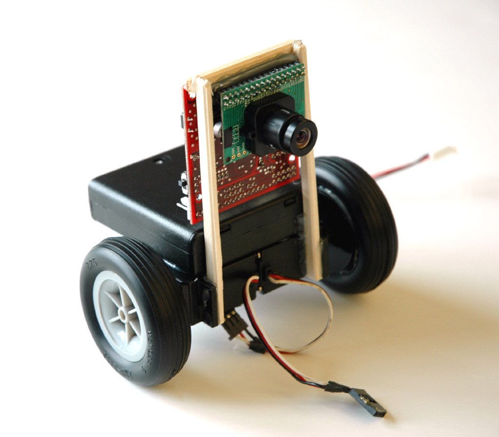

Step 8: Glue Two Chopstick Posts
Step 9: Trim Chopsticks and Glue on Top Crossbar
Step 10: Attach CMUcam3
Step 10
Liberally glue the CMUcam3 to the top chopstick bar. We used glue on both sides to make sure it was secure.

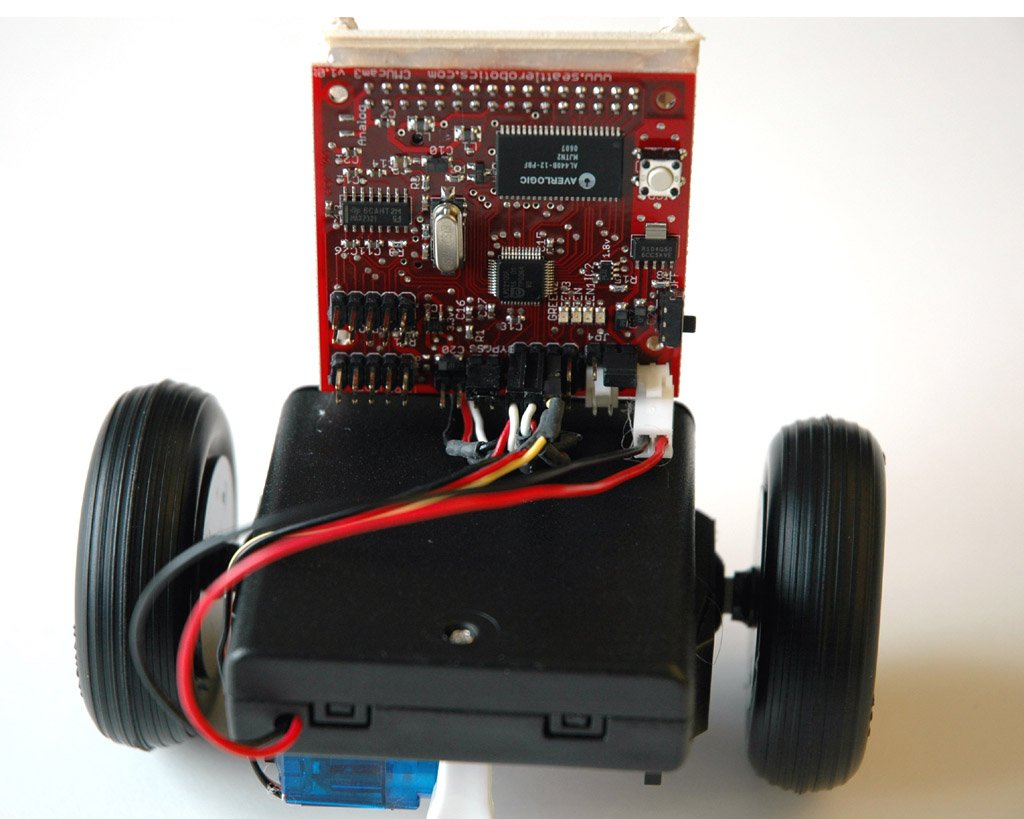

Step 11: Connect Power and Servo Wires
Step 11
  • Connect the right wheel servo (as viewed from front) to Servo Port 0.
  • Connect the left wheel servo to Servo Port 1.
  • Connect the spoon actuation servo to Servo Port 2.
  • See hardware-servo for servo port numbers.
