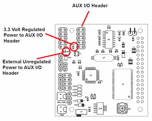

Warning: Do not connect a Tmote Sky board directly to the CMUcam3 and power both devices off of an AC adapter with resistor R6 installed!
By default the AUX POWER pin on the CMUcam3’s AUX I/O header is directly connected to the power input to the CMUcam3. This allows an external connection to the AUX I/O header to power the CMUcam3 board. In many cases when the CMUcam3 is given a large power supply such as from an outlet, you may want to change this configuration to power the wireless node directly from the CMUcam’3 internal regulator. This can be done by moving the resistor at R6 to R11. It is also possible to run the CMUcam3 and the sensor board independently by removing both R6 and R11. This can be a useful configuration if you would like the sensor node to be able to power the CMUcam3 on and off using the Power Enable pin on the CMUcam3.
AUX I/O power diagram
