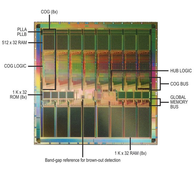

P8X32A Propeller Chip Information#
The CMUcam4 is powered by the P8X32A (Propeller Chip) from Parallax.
(Image provided by Parallax)

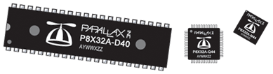

For more information about the Propeller Chip please see the Propeller P8X32A Q&A.
Additionally, please see the following websites for useful Propeller Chip downloads:
Propeller Downloads - Parallax.
You can find the Propeller Tool (Windows GUI IDE) or BST (Windows/Macintosh/Linux GUI IDE) here.
Propeller Object Exchange - Parallax.
You can find free open source software here.

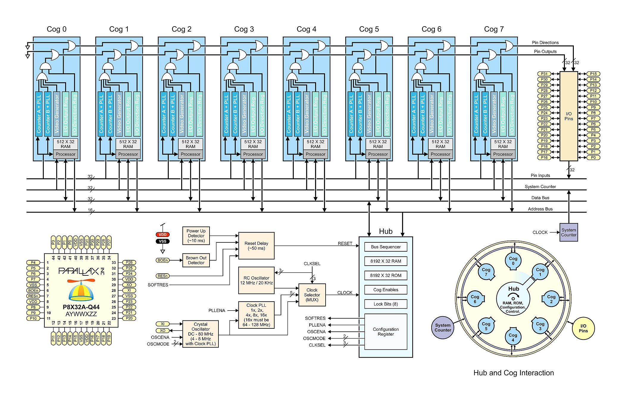

For future reference, here are the P8X32A Manual, P8X32A Datasheet, and P8X32A Quick Reference.
(Documents provided by Parallax)
NOTE: The CMUcam4 overclocks the Propeller Chip to 96 Mhz (over the default of 80 Mhz) to achieve better performance (24 MIPS per core x 8 = 192 MIPS over 20 MIPS per core x 8 = 160 MIPS).
