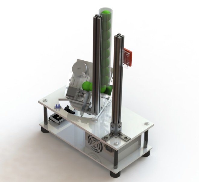

Multi-shot cannon render Multi-shot cannon
Multi-shot cannon render (full size)Multi-shot cannon (full size)

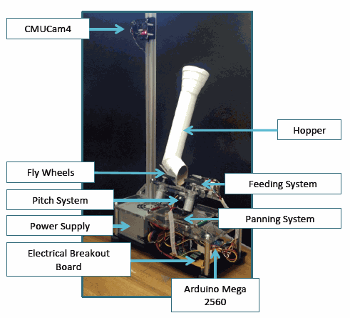

The CMUcam4 provides simple vision capabilities to small embedded systems in the form of an intelligent sensor. We used the CMUcam4 for on-board, real-time vision processing tasks (Figure 3).

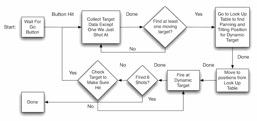

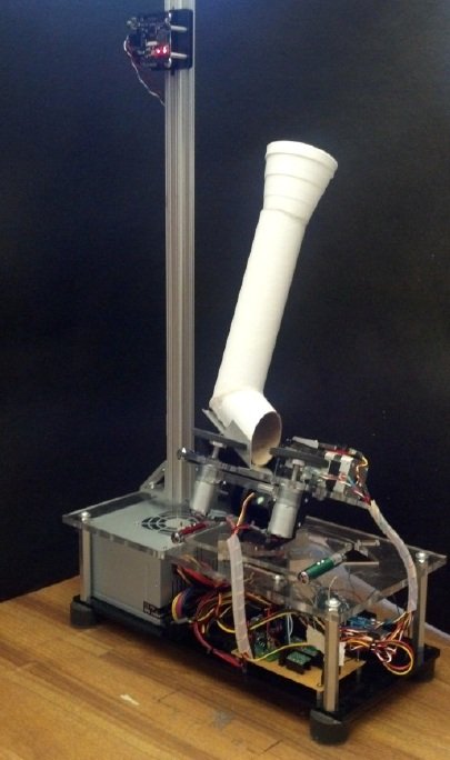

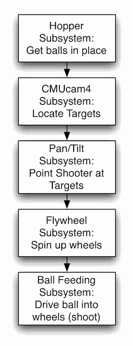

The CMUcam4 is connected to the Arduino Mega via serial over a UART port. With this, we can send commands to the CMUcam4 and receive tracking data back. Figure 4 shows the Hardware Layout of our system. Figure 5 shows the state flow of our system. Figure 6 shows the overall subsystem flow of our system.

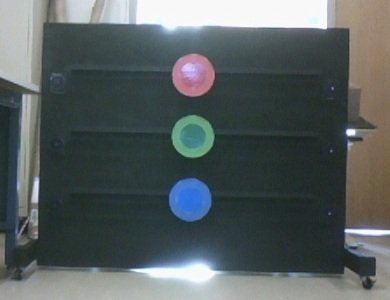

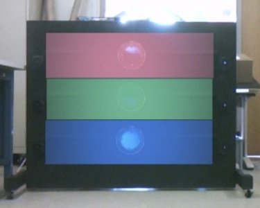

The strategy we used for this was very simple. We knew the relative y-coordinate positions of the targets relative to our position. We also knew the maximum and minimum x-coordinate positions of the targets relative to our position. So we constructed a window around the possible positions of each target as shown in Figure 2. What this did was eliminate any outside noise due to the lighting or other objects. What this also allowed was the ability to really target the red, green, and blue models against the black background. We could then accept a wide range of color values in light and darkness. Figure 1 is the view from the CMUcam4 of the target board.

../../_images/Target_raw.jpg
Figure 1 - View of Target Board.#
../../_images/Target_filtered.jpg
Figure 2 - View of Target Board with Bounding Box Filtering.#
../../_images/System_overview.png
Figure 3 - System Overview.#
../../_images/Hardware_layout.png
Figure 4 - Hardware Layout.#
../../_images/State_machine.png
Figure 5 - Overall State Machine.#
../../_images/System_flow.png
Figure 6 - Overall Subsystem Flow.#
