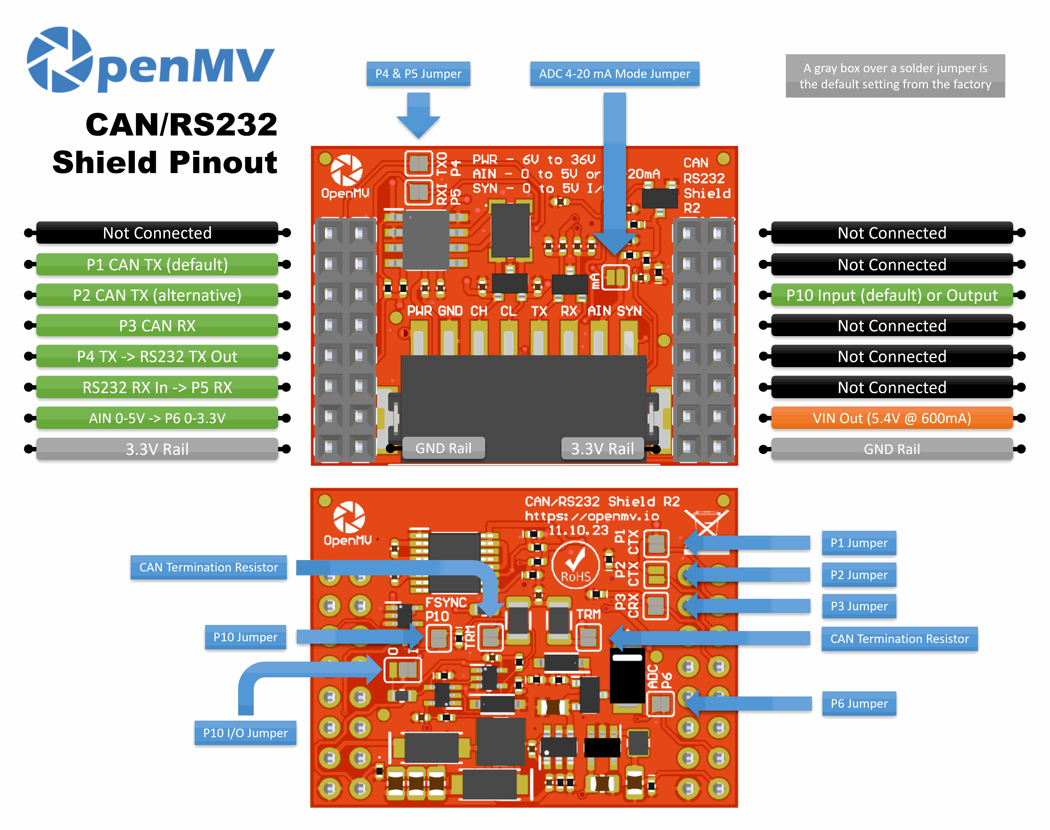

Pinout#
CAN/RS232 Shield Pinout
Pin reference#
CAN TX → transceiver in (default)
CAN TX → transceiver in (alternative)
CAN RX ← transceiver out
RS-232 TX → drives the line out
RS-232 RX ← receives the line in
Level-shifted AIN readback (0–3.3 V on P6)
SYN — open-drain digital I/O on the terminal block
PWR in
AIN in
Analog input on the terminal block
5.4 V at up to 600 mA from the on-board regulator
3.3V rail
GND rail
Common ground
AIN is overvoltage-protected up to ±36 V and defaults to a 0–5 V voltage input, scaled down to 0–3.3 V on P6. Bridge the 4–20 mA mode shunt on the front of the shield to switch AIN to a 4–20 mA current-loop input.
SYN is an open-drain digital line, pulled up to 3.3 V on the camera side and 5 V on the SYN terminal side. By default it’s an input — the shield level-shifts 0–5 V on SYN down to 0–3.3 V on P10. Change the on-board solder jumper to flip P10 into an output, level-shifting 0–3.3 V on P10 up to 0–5 V on SYN.
Each of P1, P2, P3, P4, P5, P6, and P10 can be reclaimed for unrelated use. P1, P3, P4, P5, P6, and P10 are connected by default — P1, P3, P6, and P10 through back-side solder jumpers, P4 and P5 through front-side solder jumpers. Open the jumper on any pin you want to free. P2 defaults to disconnected: bridge its back-side jumper to route CAN TX to P2 instead (and open P1’s back-side jumper to release P1).
The P1/P2 split exists so the shield works across processor families. The OpenMV Cam IMXRT boards (RT1062) can route CAN to P1, so they use the default mapping. STM32 boards can’t reach P1 with their CAN peripheral, so bridge P2’s back-side jumper (and open P1’s) to use the alternative.
The CAN bus termination is connected by default — split into two 60 Ω halves in series between CANH and CANL with a cap to ground at the midpoint (a 120 Ω AC-coupled split termination). Open the two solder pads to disconnect each half independently.
