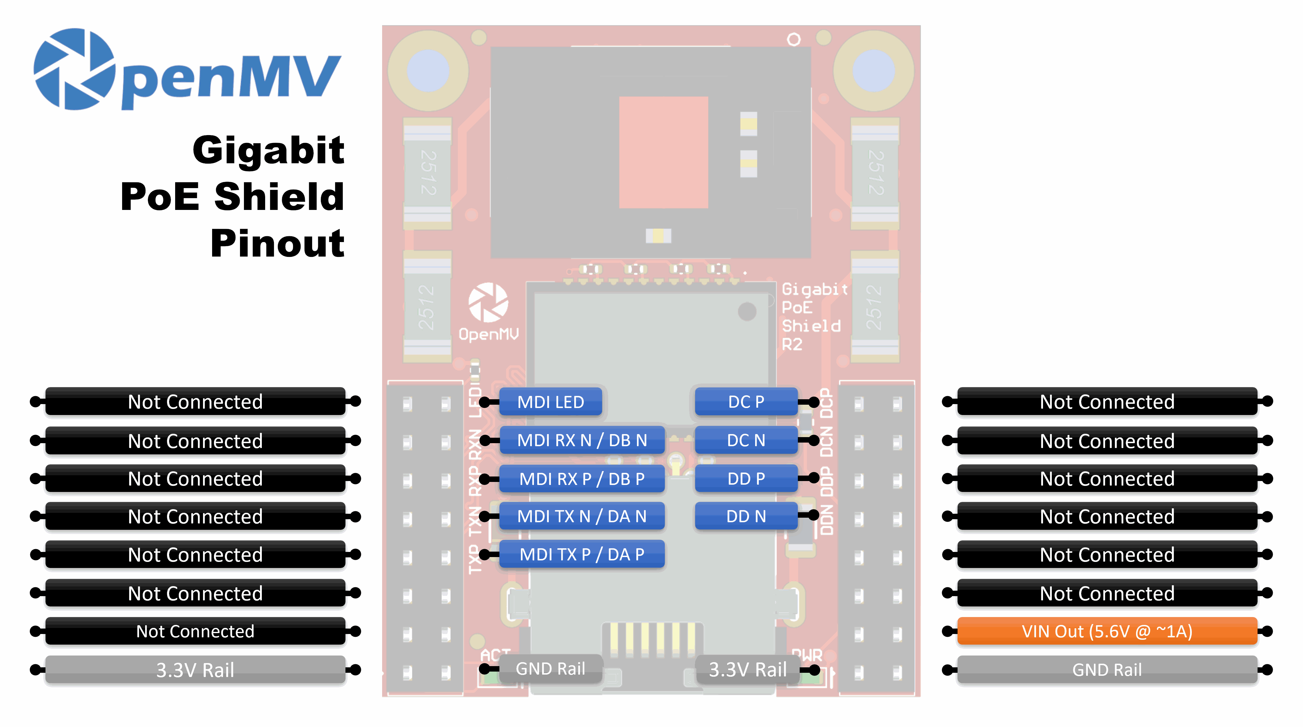

Pinout#
Gigabit PoE Shield Pinout
Pin reference#
10/100 Mb/s only uses the MDI TX and MDI RX pairs (Pairs A and B). Gigabit (1000BASE-T) is bidirectional on all four pairs A/B/C/D, so the MDI TX ± and MDI RX ± lines double as Pair A and Pair B at gigabit speeds, and Pairs C and D carry the additional gigabit-only pairs.
MDI LED
PHY link / activity LED line
MDI TX P / DA P
Pair A positive — MDI TX+ at 10/100, BI_DA+ at gigabit
MDI TX N / DA N
Pair A negative — MDI TX− at 10/100, BI_DA− at gigabit
MDI RX P / DB P
Pair B positive — MDI RX+ at 10/100, BI_DB+ at gigabit
MDI RX N / DB N
Pair B negative — MDI RX− at 10/100, BI_DB− at gigabit
DC P
Pair C positive (BI_DC+) — gigabit only
DC N
Pair C negative (BI_DC−) — gigabit only
DD P
Pair D positive (BI_DD+) — gigabit only
DD N
Pair D negative (BI_DD−) — gigabit only
5.6 V at up to ~1 A from the on-board PoE regulator (powers the camera)
3.3V rail
GND rail
Common ground
The DC and DD pairs are tied to the camera through 0-ohm resistors on the back of the shield. Remove them to free P15–P18 (the gigabit-only pins on cams like the OpenMV N6) for unrelated use — the shield then drops to 10/100 Ethernet since the gigabit pairs are no longer connected.
