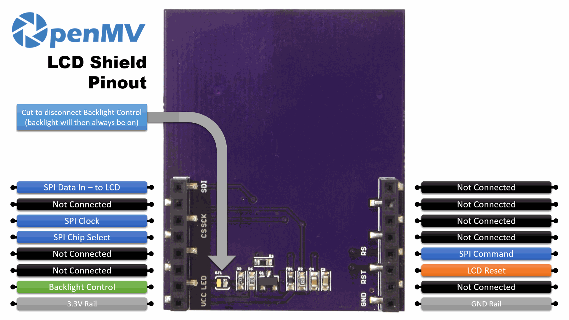

Pinout#
LCD Shield Pinout
Pin reference#
SPI MOSI — data out to the LCD
SPI clock
SPI chip select
Backlight control
LCD reset
SPI command (data / command select)
3.3V rail
Powers the LCD
GND rail
Common ground
Cut the solder trace on the back of the shield to disconnect P6 from the backlight; the backlight is then permanently on.
