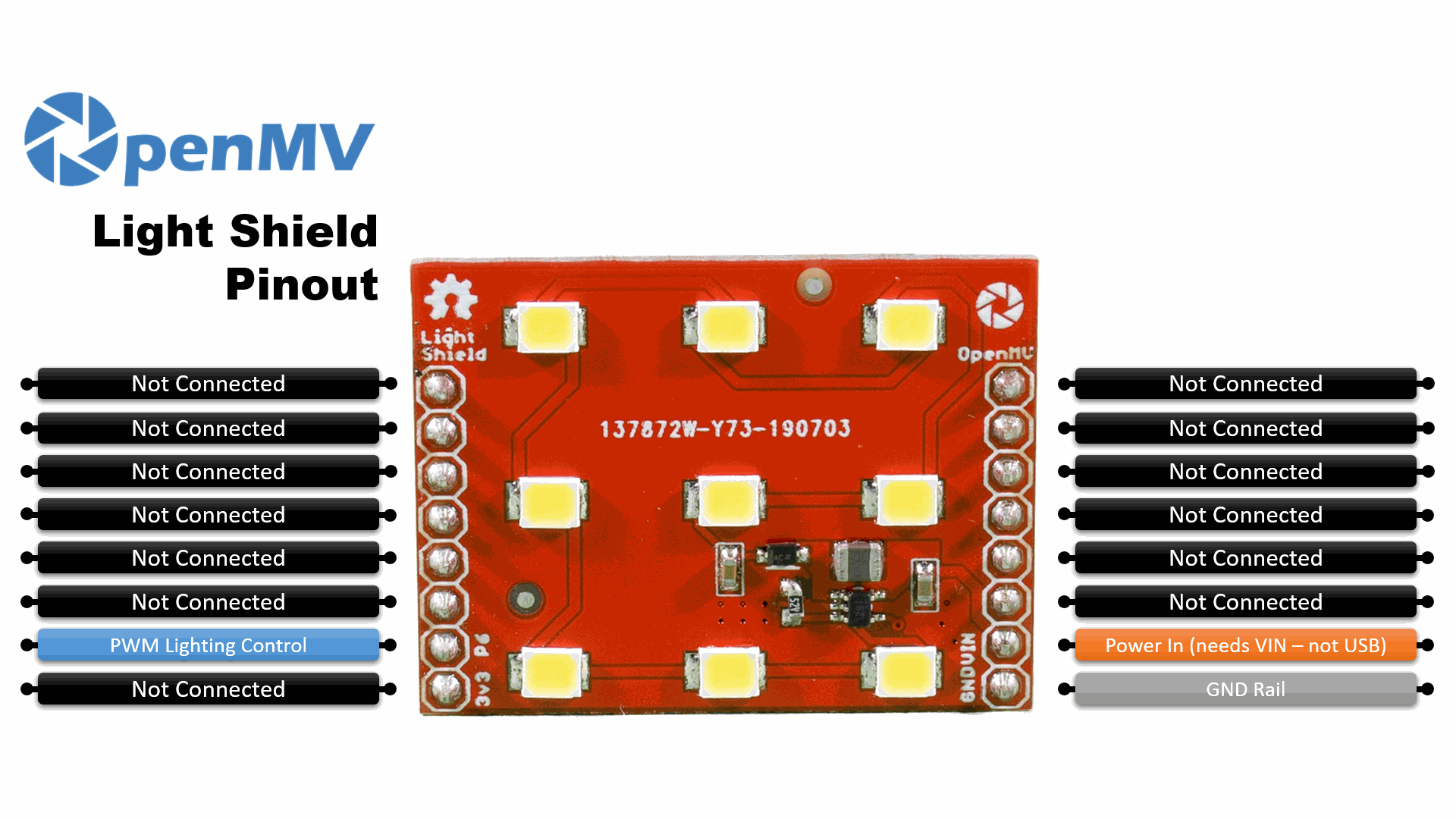

Pinout#
Light Shield Pinout
Pin reference#
PWM lighting control — drives the TPS61169 LED driver
VIN rail
Powers the LEDs (from the camera’s VIN pin)
3.3V rail
GND rail
Common ground
The shield draws LED power straight from the camera’s VIN pin. USB does not feed VIN on any OpenMV Cam, so VIN must be supplied externally (battery, bench supply, or similar) — pick a source rated for the combined current draw of all nine LEDs at full brightness.
