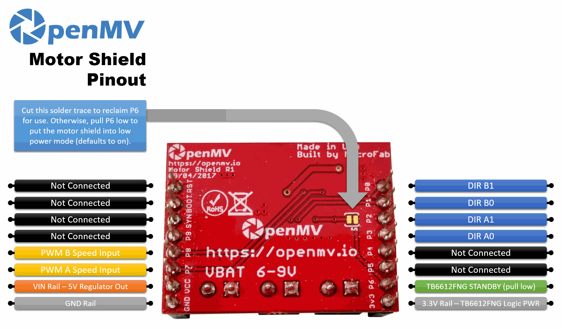

Pinout#
Motor Shield Pinout
Pin reference#
DIR B1 (motor B direction)
DIR B0 (motor B direction)
DIR A1 (motor A direction)
DIR A0 (motor A direction)
TB6612FNG STANDBY — defaults on; pull low to enter low-power mode
PWM speed input for motor A
PWM speed input for motor B
VBAT in
6.5–18 V battery input on the screw terminal (NCP1117 limits)
5 V from the on-board NCP1117 regulator (powers the camera)
3.3V rail
Powers the TB6612FNG logic
GND rail
Common ground
P6 drives the TB6612 STANDBY input by default. Cut the solder trace on the back of the shield to disconnect P6 if you’d rather use the pin for something else (the driver then stays enabled).
