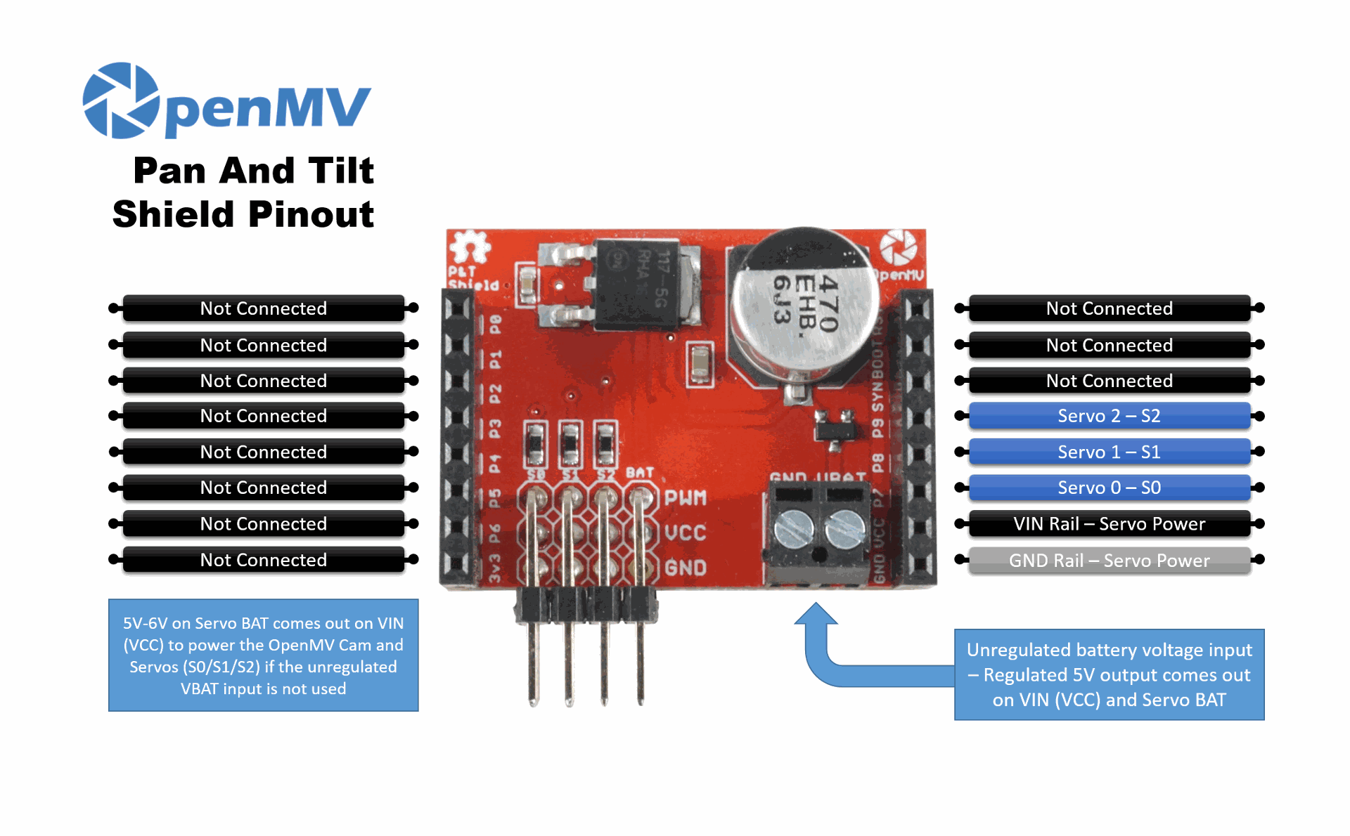

Pan and Tilt Shield Pinout
Pin reference#
Servo 0 (S0)
Servo 1 (S1)
Servo 2 (S2)
VBAT in
6.5–18 V battery input on the screw terminal (NCP1117 limits)
5 V regulated from the on-board NCP1117 — powers both the camera and the servo rail
GND rail
Servo and camera common ground
