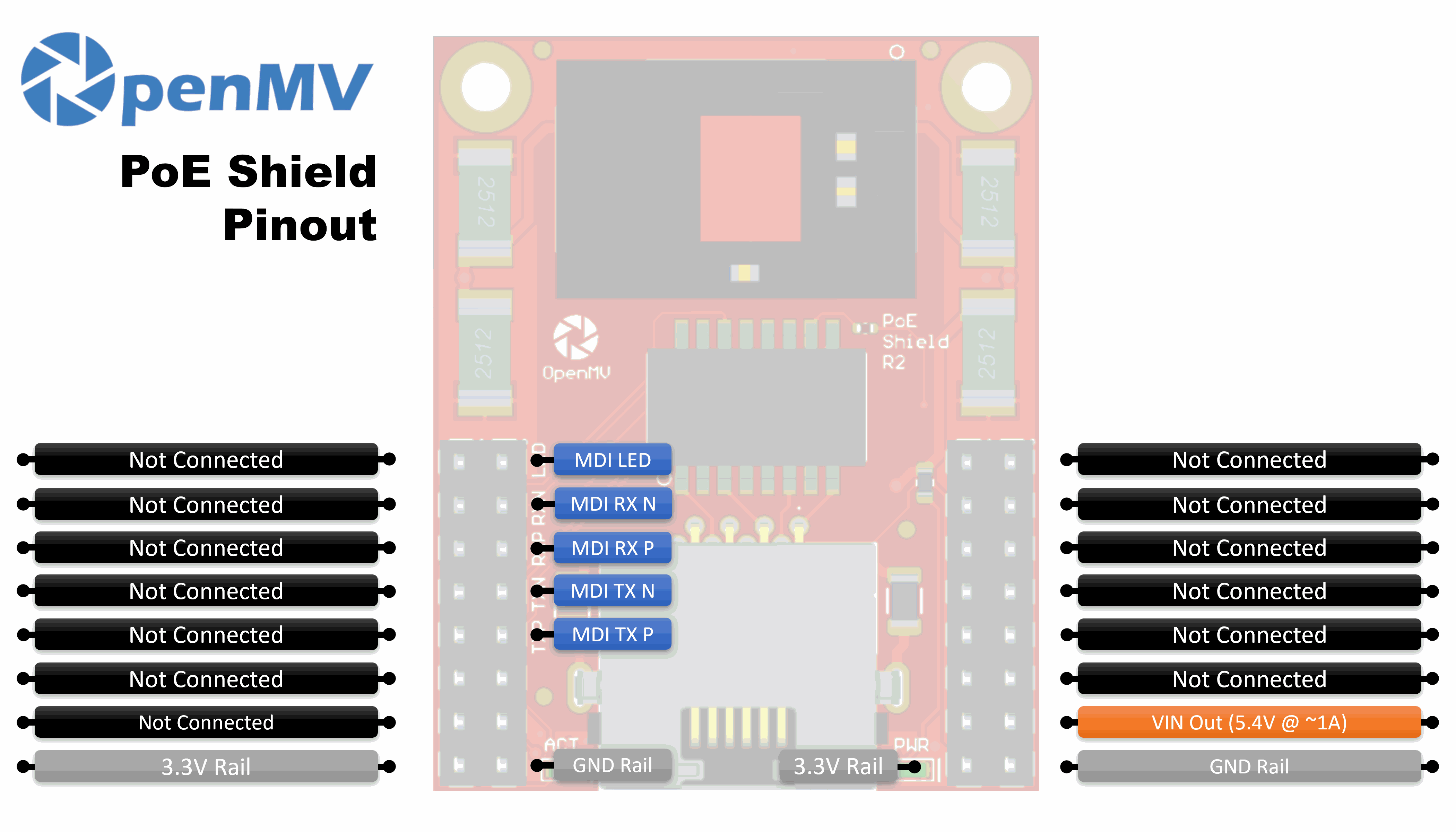

Pinout#
PoE Shield Pinout
Pin reference#
MDI LED
PHY link / activity LED line
MDI TX P
MDI TX+ — transmit pair positive
MDI TX N
MDI TX− — transmit pair negative
MDI RX P
MDI RX+ — receive pair positive
MDI RX N
MDI RX− — receive pair negative
5.4 V at up to ~1 A from the on-board PoE regulator (powers the camera)
3.3V rail
GND rail
Common ground
