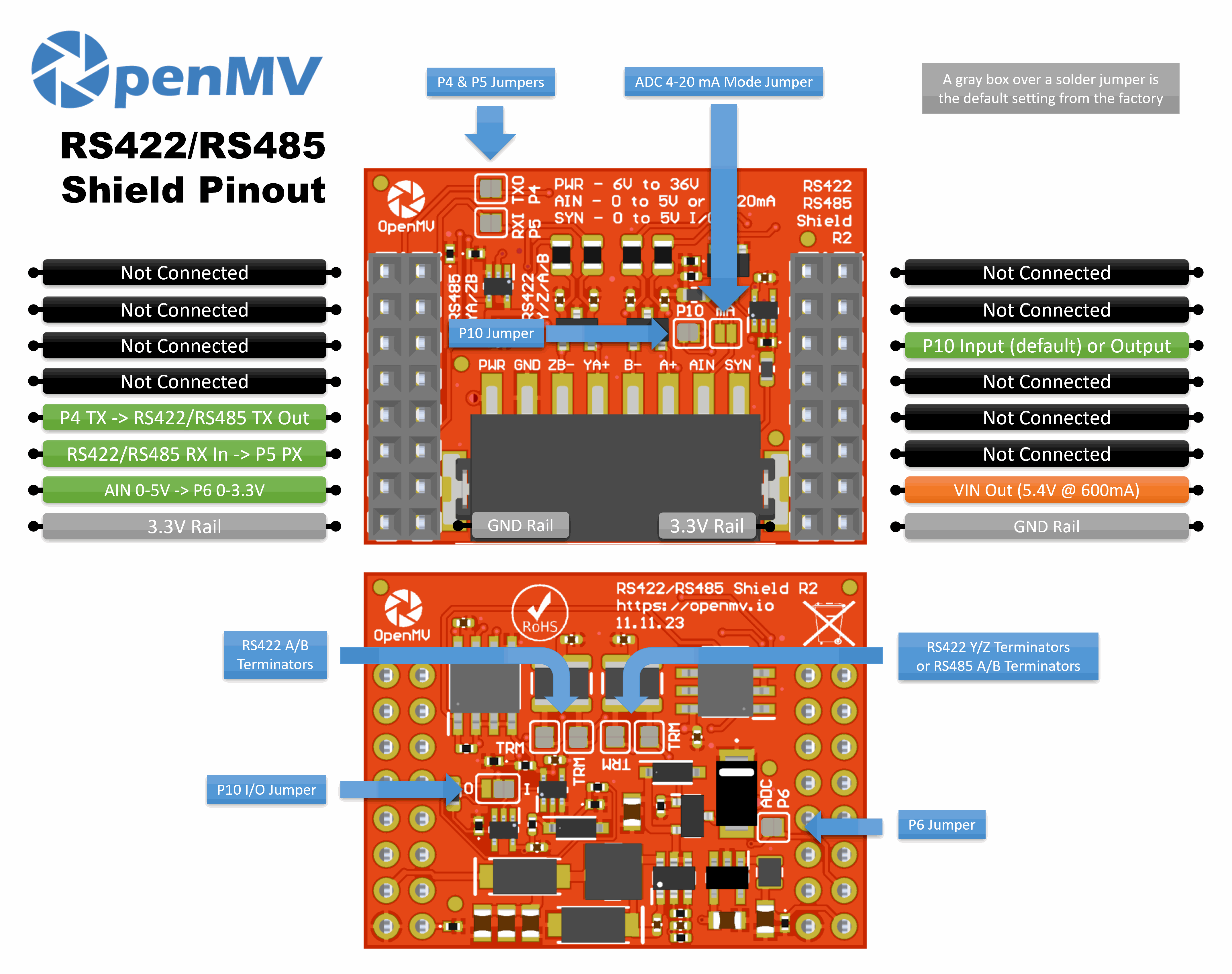

Pinout#
RS422/RS485 Shield Pinout
Pin reference#
RS-422 / RS-485 TX → drives the differential line out
RS-422 / RS-485 RX ← receives differential line in
Level-shifted AIN readback (0–3.3 V on P6)
SYN — open-drain digital I/O on the terminal block
PWR in
AIN in
Analog input on the terminal block
5.4 V at up to 600 mA from the on-board regulator
3.3V rail
GND rail
Common ground
AIN is overvoltage-protected up to ±36 V and defaults to a 0–5 V voltage input, scaled down to 0–3.3 V on P6. Bridge the 4–20 mA mode shunt on the front of the shield to switch AIN to a 4–20 mA current-loop input.
SYN is an open-drain digital line, pulled up to 3.3 V on the camera side and 5 V on the SYN terminal side. By default it’s an input — the shield level-shifts 0–5 V on SYN down to 0–3.3 V on P10. Change the on-board solder jumper to flip P10 into an output, level-shifting 0–3.3 V on P10 up to 0–5 V on SYN.
Each of P4, P5, P6, and P10 is connected to the camera by default through a solder jumper — open the jumper on any pin you want to reclaim for unrelated use. P6’s jumper is on the back of the shield; P4, P5, and P10 are on the front.
The on-board termination resistors are connected by default — open the corresponding back-side solder jumpers to disconnect them. Two cover the RS-422 A/B pair and two cover the RS-422 Y/Z pair (which doubles as the RS-485 A/B termination), four jumpers in total.
