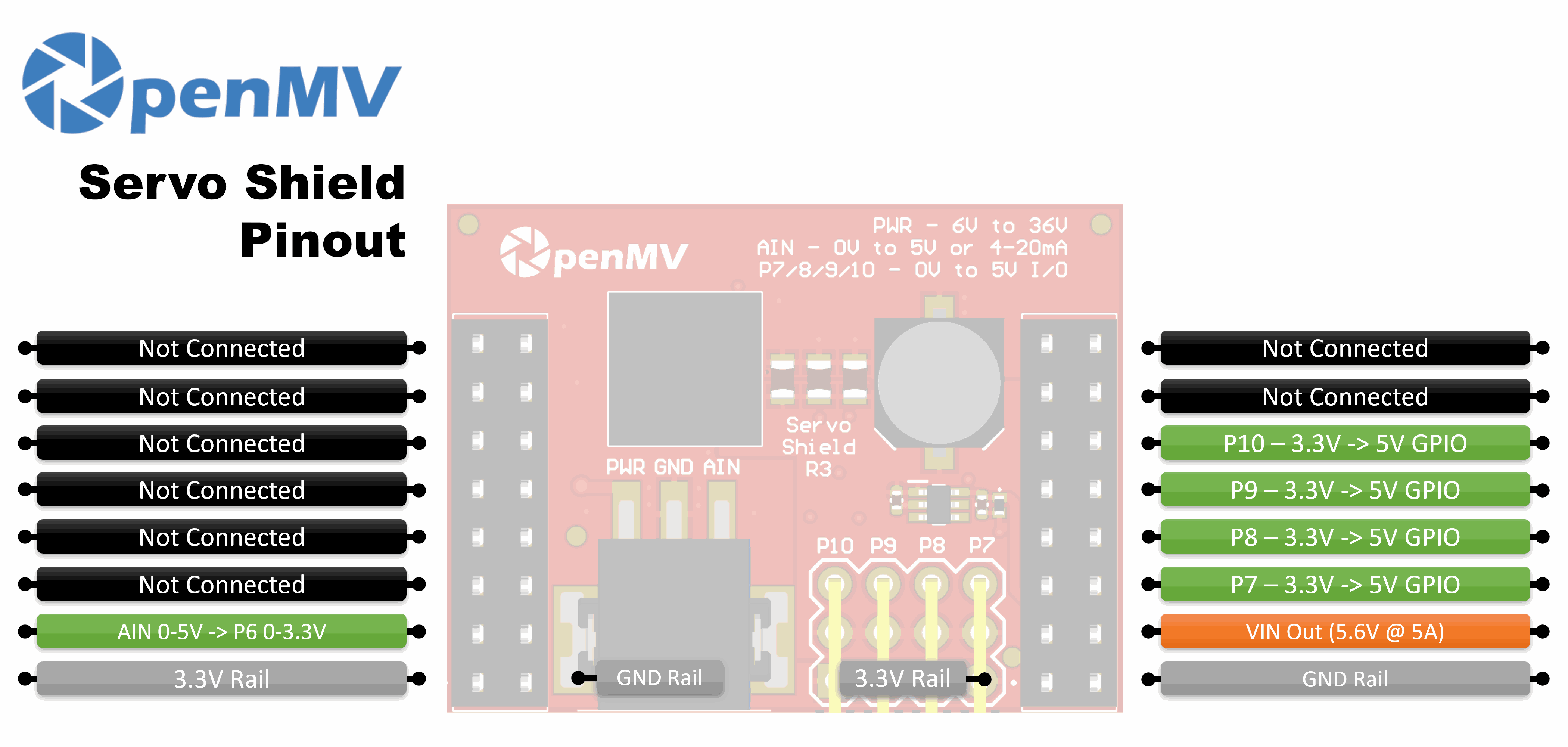

Pinout#
Servo Shield Pinout
Pin reference#
Level-shifted AIN readback (0–3.3 V on P6)
Servo 1 — bidirectional 3.3 V ↔ 5 V GPIO
Servo 2 — bidirectional 3.3 V ↔ 5 V GPIO
Servo 3 — bidirectional 3.3 V ↔ 5 V GPIO
Servo 4 — bidirectional 3.3 V ↔ 5 V GPIO
PWR in
AIN in
Analog input on the terminal block
5.6 V regulated, up to 5 A combined for servos and camera
3.3V rail
GND rail
Common ground
AIN is overvoltage-protected up to ±36 V and defaults to a 0–5 V voltage input, scaled down to 0–3.3 V on P6. Bridge the 4–20 mA mode shunt on the back of the shield to switch AIN to a 4–20 mA current-loop input.
Each of P6–P10 is tied to the camera through a 0-ohm resistor on the back of the shield. Remove the resistor on any pin you want to reclaim for unrelated use.
On the v2 version of the shield, P6–P9 are unidirectional 3.3 V → 5 V level shifters (output only). P10 is an open-drain digital line, pulled up to 3.3 V on the camera side and 5 V on the servo-pin side. By default it’s an input — the shield level-shifts 0–5 V on the servo pin down to 0–3.3 V on P10. Change the on-board solder jumper to flip P10 into an output, level-shifting 0–3.3 V on P10 up to 0–5 V on the servo pin.
