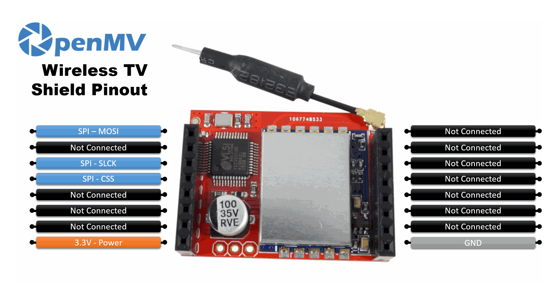

Pinout#
Wireless TV Shield Pinout
Pin reference#
SPI MOSI — data to the VS23S010
SPI clock
SPI chip select
3.3V rail
Powers the VS23S010 and 5.8 GHz transmitter
GND rail
Common ground (also routed to the front-edge video breakout)
The NTSC video output, VIN, and GND are also broken out to through-hole pads on the bottom of the shield — solder wires there to take the wired composite video signal off the board.
