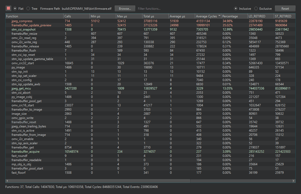

The profiler watching a script run: per-function calls, timing, and percentage of total time, with two hardware event counters in the rightmost columns and the totals line underneath.#
The window is a sortable table of functions with their call counts, minimum, maximum, total, and average microseconds, average cycles, and percentage of total time, with a totals line underneath and a filter box for finding functions by name. Function names come from the firmware’s ELF file – point the window’s firmware path field at the .elf produced by the build, and addresses resolve to names.
Two view controls organize the data. Flat ranks every function independently – the view for “what is the single most expensive function.” Tree nests callees under callers, showing how time decomposes down the call chain. Independently, Inclusive charges a function for the time spent in everything it called, while Exclusive counts only the function’s own body – inclusive finds the expensive subsystem, exclusive finds the expensive loop. Reset zeroes the counters, which is how you measure one stage of a pipeline in isolation: reset, let it run, read.
