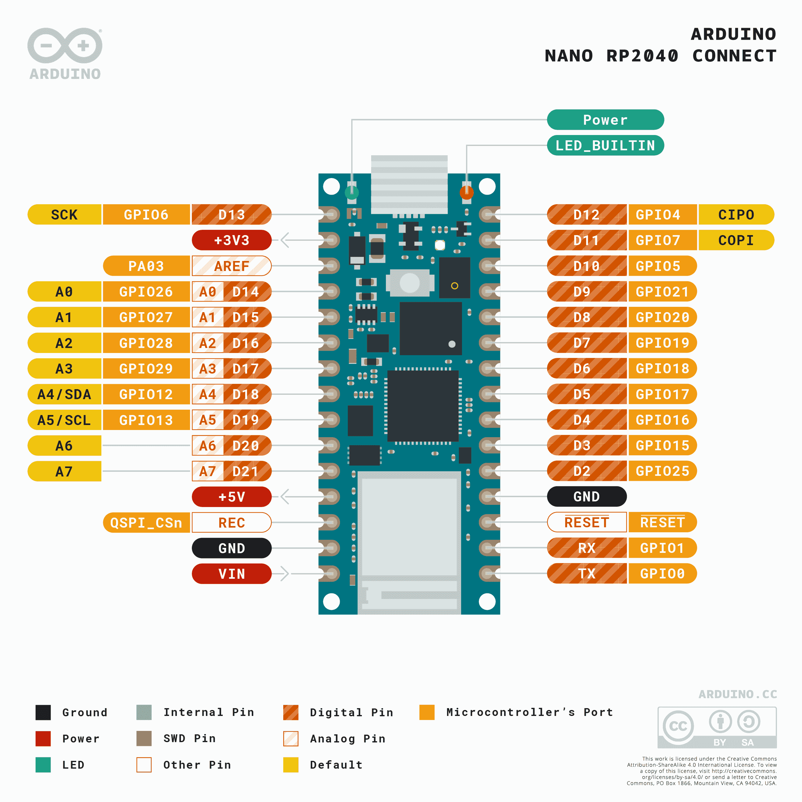

The Arduino Nano RP2040 Connect is a 45 × 18 mm Arduino‑Nano‑form‑factor board built around the Raspberry Pi RP2040 — a dual ARM Cortex‑M0+ running at 133 MHz with 264 KB of internal SRAM. WiFi and BLE come from a U‑blox NINA‑W102 module, and the board carries an LSM6DSOX 6‑axis IMU and an MP34DT06 PDM microphone. The OpenMV firmware drives all of these from MicroPython.
For full datasheet, photos, and dimensions see the Arduino Nano RP2040 Connect product page.

Pin reference
Pin name
Reference
D14 / A0
D15 / A1
D16 / A2
D17 / A3
D18 / A4 / SDA
D19 / A5 / SCL
D20 / A6
ADC / GPIO
D21 / A7
ADC / GPIO
press the on‑board RESET button or pull to GND to reset
REC
BOOTSEL — pull high at power‑on to enter the RP2040 ROM bootloader
Orange user LED on D13
RGB LED red channel
RGB LED green channel
RGB LED blue channel
Warning
The Nano RP2040 Connect’s I/O pins are 3.3 V only — they are not 5 V tolerant. Driving 5 V into them will damage the RP2040.
Power pins
  • VIN — 4 – 20 V input. Powers the board through the on‑board switching regulator. Also fed via a diode from the USB 5 V rail, so USB and VIN can be present at the same time without back‑driving each other.
  • +5V — unconnected by default.
  • +3V3 — 3.3 V regulator output.
  • AREF — analog reference pin. Not wired to the RP2040 on this board — the ADC is always referenced to 3.3 V.
  • GND — common ground.
The Nano RP2040 Connect can be powered through either path:
  • Micro USB — supplies 5 V to the on‑board regulator.
  • VIN pin — drive a regulated 4 – 20 V supply.
A solder jumper on the bottom of the board bridges +5V to the USB 5 V rail. Close it to make the +5V header pin actually carry 5 V.
A normally‑closed solder jumper on the output of the on‑board 4–20 V switching regulator can be cut to disable the regulator, so the board can be powered directly from an external 3.3 V supply on +3V3.
Recovery and debug pins
  • RESET — both an exposed pad and a momentary RESET button on the top of the board, tied to the RP2040’s NRST line. Pull to GND or press the button to reset.
  • REC — exposed pad. Holding REC high at power‑on (or while pressing RESET) puts the RP2040 into its ROM bootloader; the board re‑enumerates as a USB mass‑storage drive named RPI-RP2 and accepts a .uf2 firmware image.
The Nano RP2040 Connect uses Arduino’s standard double‑tap reset to enter Arduino’s bootloader. Quickly press the RESET button twice — the board re‑enumerates over USB as a UF2 device and OpenMV IDE can flash a new firmware image.
The RP2040’s SWD signals are exposed on plated pads on the back of the board, just below the NINA module. All debug signals are 3.3 V referenced.

The RP2040 has four 12‑bit ADC channels exposed on A0–A3, all 3.3 V referenced — read_u16 returns 0–65535 across 0–3.3 V at the pin. The board’s AREF pin is not wired, so the reference is always 3.3 V:
Slice / channel
PWM0 A
PWM0 B
PWM4 B
PWM7 B
PWM0 A
PWM0 B
PWM1 A
PWM1 B
PWM2 A
PWM2 B
PWM2 B
PWM3 B
PWM2 A
PWM3 A
D14 / A0
PWM5 A
D15 / A1
PWM5 B
D16 / A2
PWM6 A
D17 / A3
PWM6 B
D18 / A4 / SDA
PWM6 A
D19 / A5 / SCL
PWM6 B
Several pins share PWM slice channels:
  • PWM0 A is on TX and D4.
  • PWM0 B is on RX and D5.
  • PWM2 A is on D8 and D12.
  • PWM2 B is on D9 and D10.
  • PWM6 A is on D16/A2 and D18/A4/SDA.
  • PWM6 B is on D17/A3 and D19/A5/SCL.
Pick one consumer per slice channel. Channels A and B inside the same slice share their period (frequency) but each has its own duty cycle.
