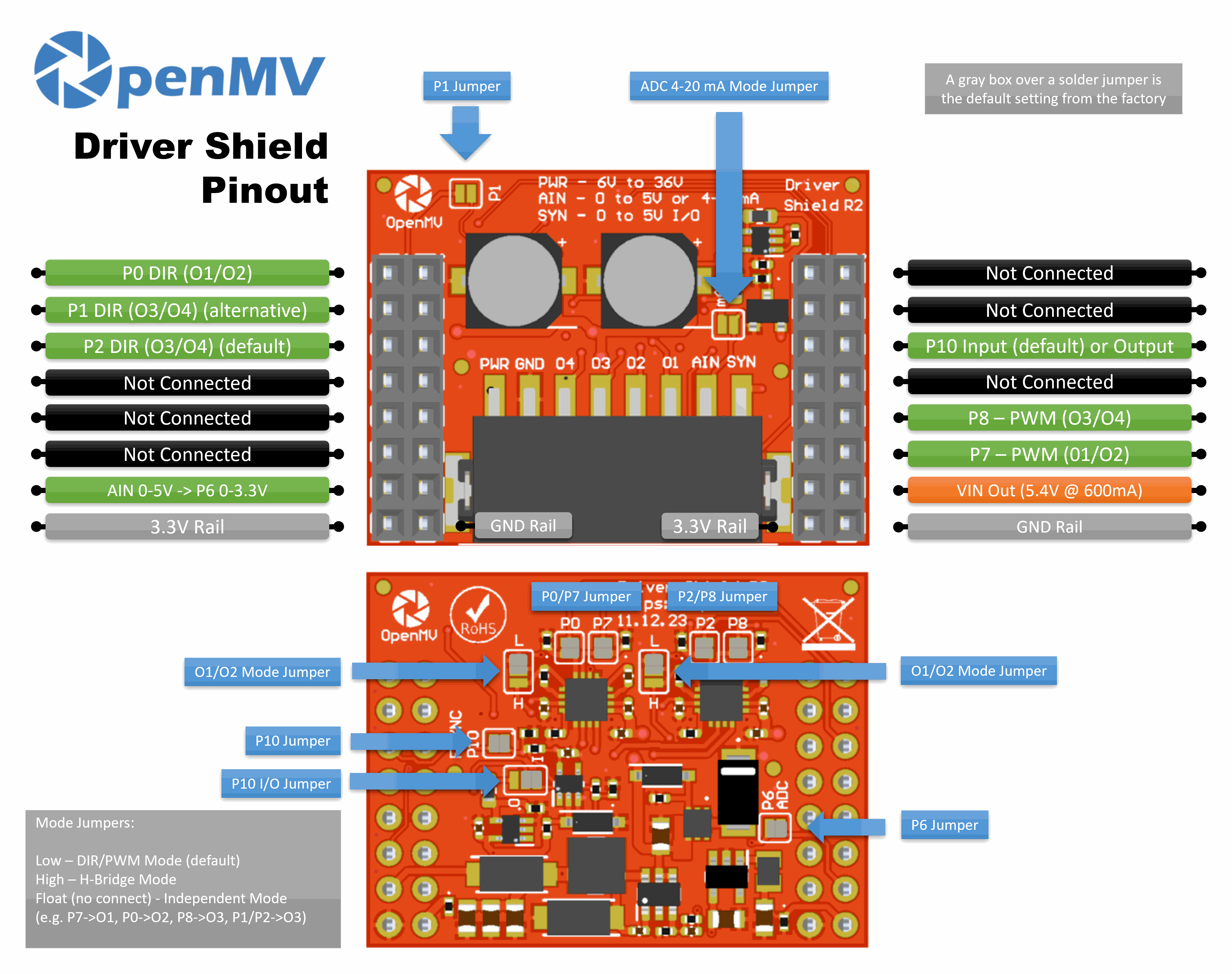

Driver Shield Pinout
Pin reference
DIR for output pair O1/O2
DIR for output pair O3/O4 (alternative)
DIR for output pair O3/O4 (default)
Level-shifted AIN readback (0–3.3 V on P6)
PWM for output pair O1/O2
PWM for output pair O3/O4
SYN — open-drain digital I/O on the terminal block
PWR in
AIN in
Analog input on the terminal block
5.4 V at up to 600 mA from the on-board regulator
3.3V rail
GND rail
Common ground
AIN is overvoltage-protected up to ±36 V and defaults to a 0–5 V voltage input, scaled down to 0–3.3 V on P6. Bridge the 4–20 mA mode shunt on the front of the shield to switch AIN to a 4–20 mA current-loop input.
SYN is an open-drain digital line, pulled up to 3.3 V on the camera side and 5 V on the SYN terminal side. By default it’s an input — the shield level-shifts 0–5 V on SYN down to 0–3.3 V on P10. Change the on-board solder jumper to flip P10 into an output, level-shifting 0–3.3 V on P10 up to 0–5 V on SYN.
Each of P0, P1, P2, P6, P7, P8, and P10 can be reclaimed for unrelated use. P0, P2, P6, P7, P8, and P10 are connected by default through back-side solder jumpers — open the jumper on any pin you want to free. P1 defaults to disconnected: bridge its front-side jumper to route DIR for O3/O4 to P1 instead (and open P2’s back-side jumper to release P2).
Two mode jumpers on the back of the shield — one per H-bridge — independently set each output pair into one of three modes. Each jumper has L and H markings to show which side selects which state:
  • Low (default) — DIR/PWM mode: one DIR pin + one PWM pin per bridge.
  • High — H-bridge mode: both pins drive the bridge directly via the chip’s two-input truth table.
  • Float (no connect) — independent mode: each pin becomes a stand-alone line driver routed to one output.
Each DRV8876 is current-limited to 3 A total per chip — that’s 3 A through one bridge (DIR/PWM or H-bridge mode) or 1.5 A per output split across the two outputs (independent mode).
