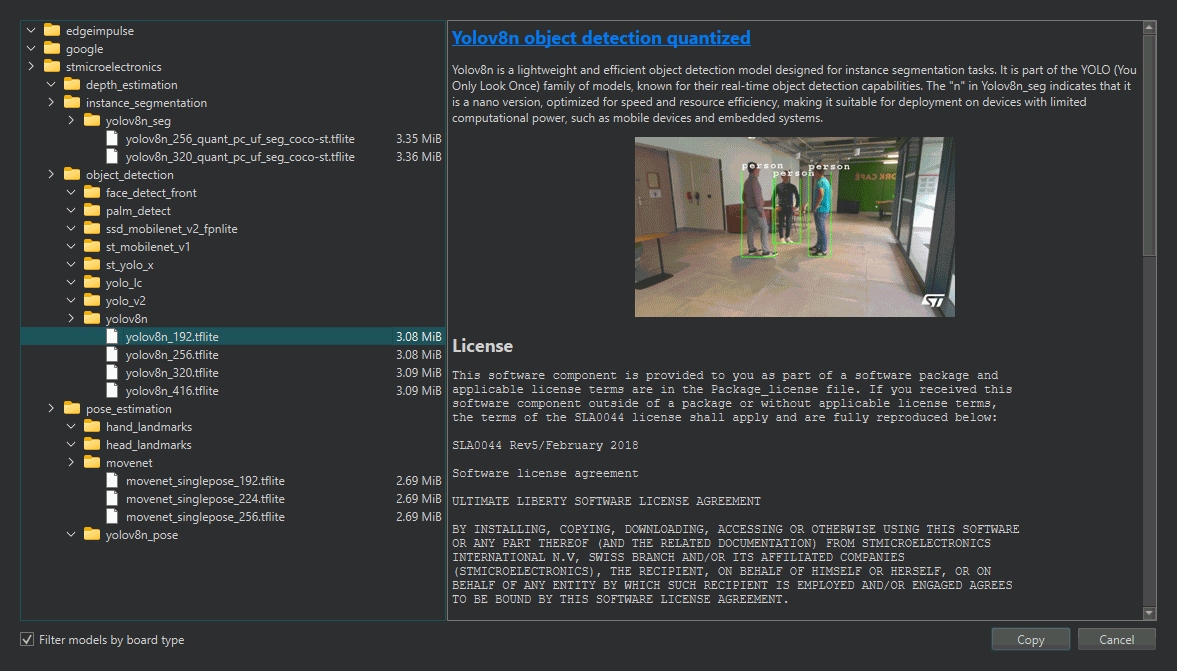

The IDE ships with a library of pretrained machine-learning models – face detection, person detection, object detection, pose estimation, and more – kept current through the IDE’s resource updates. Tools → Machine Vision → Open Model Zoo browses it: select a model to see its description page alongside the file tree, and tick the filter to narrow the list to models that fit your board.
The Model Zoo browser with a model selected and its description page open.¶
Choose a model and the IDE copies it out ready to run: it converts the model for the target board’s NPU accelerator when the board has one, copies the matching labels file alongside it, and defaults the destination to the connected camera’s drive. From there the script side is one ml.Model constructor call away. The same browser is reachable from inside the ROMFS editor, which is the better destination for models on boards that have ROMFS – models in ROMFS execute straight from flash without a RAM copy.
