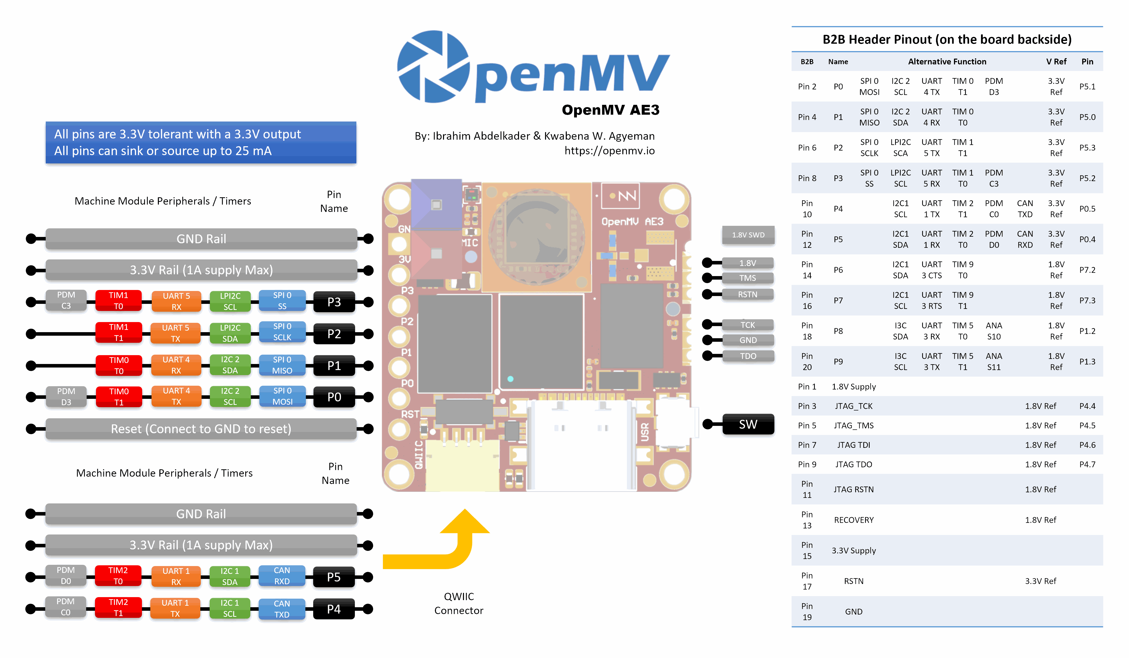

Pinout#
OpenMV AE3 PAG7936 Pinout
Pin reference#
The AE3 exposes 10 user pins on the side headers (P0–P9). Additional signals — including JTAG and the recovery line — are routed to a B2B (board‑to‑board) header on the back of the board for shields and carrier boards.
Pin name
Reference
1.8 V
I2C1 SDA / UART3 CTS / TIM9 T0 (B2B only)
1.8 V
I2C1 SCL / UART3 RTS / TIM9 T1 (B2B only)
1.8 V
I3C SDA / UART3 RX / TIM5 T0 / ADC ch S10 (B2B only)
1.8 V
I3C SCL / UART3 TX / TIM5 T1 / ADC ch S11 (B2B only)
1.8 V
GPIO / JTAG TCK (B2B only)
1.8 V
GPIO / JTAG TDO (B2B only)
1.8 V
GPIO / JTAG TMS (B2B only)
1.8 V
GPIO / JTAG TDI (B2B only)
user button (active low)
P0–P5 are on the side headers (3.3 V referenced); P6–P9 are exposed only on the B2B header on the back of the board and are 1.8 V referenced. Driving 3.3 V into a 1.8 V‑referenced pin will damage the SoC — make sure any signal connected to the B2B header is at 1.8 V.
