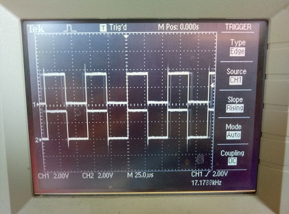

Pins 16 and 17 are switched synchronously:
../../_images/mem32_gpio_output.jpg
Same image on pins 32 and 33.
