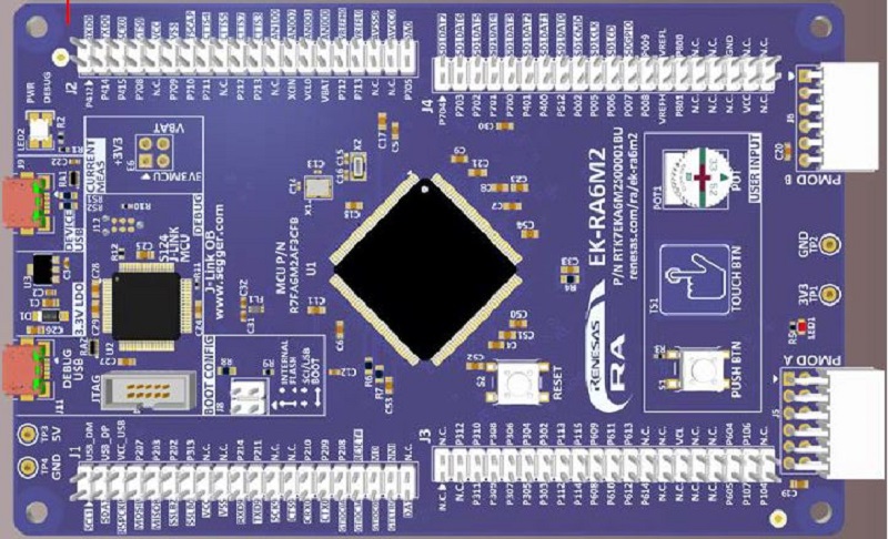

Renesas Evaluation Kit for RA6M2 MCU Group
The Renesas EK-RA6M2 board.
Below is a quick reference for the Renesas RA boards. If it is your first time working with this board, it may be useful to get an overview of the microcontroller and the board:
