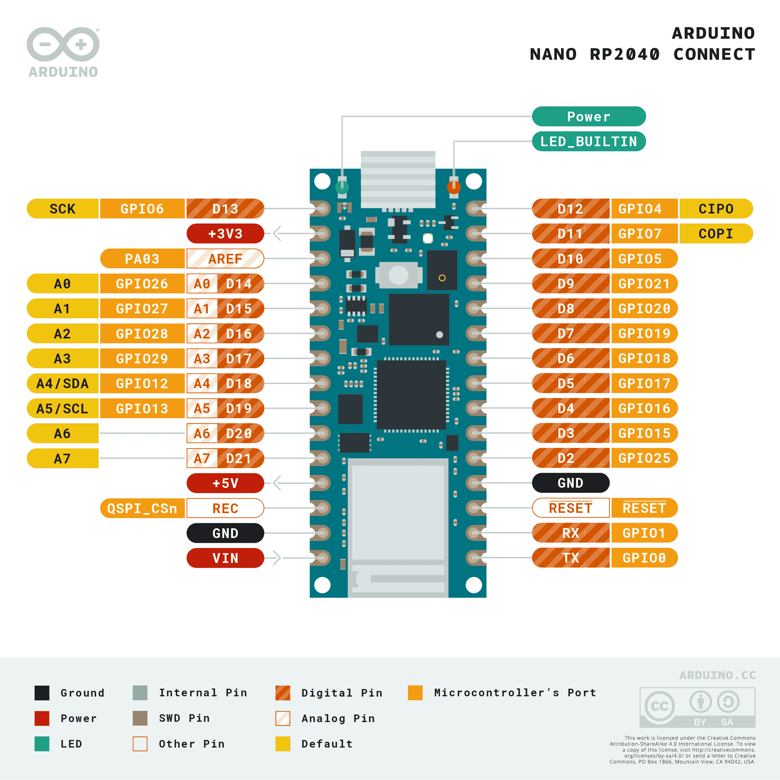

Raspored pinova
Raspored pinova Arduino Nano RP2040 Connect
Referenca pinova
Naziv pina
Referenca
Funkcija
TX
3.3 V
UART0 TX / SPI0 RX / I2C0 SDA / PWM0 A
RX
3.3 V
UART0 RX / SPI0 CS / I2C0 SCL / PWM0 B
D2
3.3 V
SPI1 CS / UART1 RX / I2C0 SCL / PWM4 B
D3
3.3 V
SPI1 TX / UART0 RTS / I2C1 SCL / PWM7 B
D4
3.3 V
SPI0 RX / UART0 TX / I2C0 SDA / PWM0 A
D5
3.3 V
SPI0 CS / UART0 RX / I2C0 SCL / PWM0 B
D6
3.3 V
SPI0 SCK / UART0 CTS / I2C1 SDA / PWM1 A
D7
3.3 V
SPI0 TX / UART0 RTS / I2C1 SCL / PWM1 B
D8
3.3 V
SPI0 RX / UART1 TX / I2C0 SDA / PWM2 A
D9
3.3 V
SPI0 CS / UART1 RX / I2C0 SCL / PWM2 B
D10
3.3 V
D11
3.3 V
SPI0 TX / UART1 RTS / I2C1 SCL / PWM3 B
D12
3.3 V
D13
3.3 V
SPI0 SCK / UART1 CTS / I2C1 SDA / PWM3 A
D14 / A0
3.3 V
ADC / SPI1 SCK / UART1 CTS / I2C1 SDA / PWM5 A
D15 / A1
3.3 V
ADC / SPI1 TX / UART1 RTS / I2C1 SCL / PWM5 B
D16 / A2
3.3 V
ADC / SPI1 RX / UART0 TX / I2C0 SDA / PWM6 A
D17 / A3
3.3 V
ADC / SPI1 CS / UART0 RX / I2C0 SCL / PWM6 B
D18 / A4 / SDA
3.3 V
ADC / I2C0 SDA / SPI1 RX / UART0 TX / PWM6 A
D19 / A5 / SCL
3.3 V
ADC / I2C0 SCL / SPI1 CS / UART0 RX / PWM6 B
D20 / A6
3.3 V
ADC / GPIO
D21 / A7
3.3 V
ADC / GPIO
RESET
3.3 V
pritisnite RESET gumb na ploči ili spojite na GND za resetiranje
REC
3.3 V
BOOTSEL — postavite na visoku razinu pri uključivanju za ulazak u RP2040 ROM pokretač (bootloader)
LED_BUILTIN
Narančasta korisnička LED na D13
LED_RED
crveni kanal RGB LED-a
LED_GREEN
zeleni kanal RGB LED-a
LED_BLUE
plavi kanal RGB LED-a
